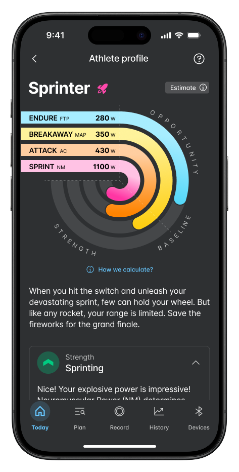

Dimensional Training Load (DTL) takes that idea further. Instead of viewing all power through the lens of FTP, it looks at your complete 4DP Athlete Profile, which measures your ability to produce power across four key dimensions:
  • Endure (FTP): long, steady aerobic power
  • Breakaway (MAP): sustained high-intensity efforts
  • Attack (AC): short, near-maximal bursts
  • Sprint (NM): peak neuromuscular power
This approach provides a far more accurate reflection of your true training stress for each activity.
For example: Imagine two riders with the same FTP. Rider A can sprint up to 700 watts, Rider B up to 1000. If both hit 700 watts during an interval, TSS sees those efforts as identical. DTL doesn’t — it recognizes that Rider A is pushing their limit while Rider B is still in their comfort zone, and it weights those efforts accordingly.

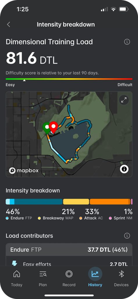

What You See in the Wahoo App
When you complete a ride with power and cadence data, the Wahoo app visualizes DTL in several ways:
  • Total DTL Score: Your overall training load for the ride, so you can see how demanding it was.
  • Relative Training Load Bar Graph: Compare that ride’s DTL to your last 90 days, so you can see if it was easier, harder, or right on target.
  • 4DP Load Distribution: Shows how your effort was divided across Endure, Breakaway, Attack, and Sprint — so you can identify which systems you trained most.
  • DTL per Hour + Map View: Plots your DTL per hour alongside your ride map, so you can pinpoint where your hardest efforts happened.
