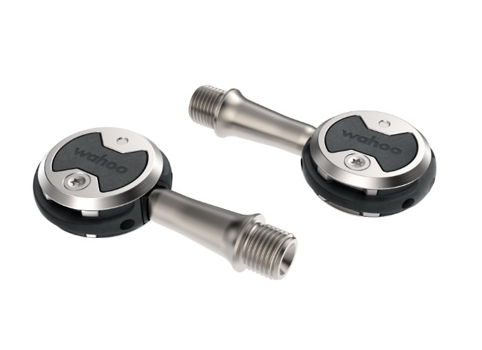

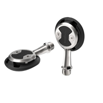

SPEEDPLAY ZERO
Most Popular
SPEEDPLAY ZERO
The Pedal That Fits Every Rider.
CA$319.99
The only SPEEDPLAY available in four spindle lengths — 53, 56, 59, and 65mm — so bike fitters and riders can dial in stance width without changing pedal systems.
A stainless steel spindle handles rain, sweat, and year-round riding without surface oxidation. At 222g per pair, lighter than the COMP while being more durable. Includes Standard Tension cleats for a firm, race-ready connection out of the box.
222g Per Pair
11.5mm Stack
0-15° Float
4 Spindles
39° Clearance
What makes the ZERO different
The ZERO is the only SPEEDPLAY available in four spindle lengths (53, 56, 59, and 65mm), making it the go-to for riders with wide hips, knee tracking issues, or anyone following a professional bike fit. Stainless steel resists rust and salt. Fore-aft (13mm), left-right (8mm), and rotational float (0–15°) are all independently adjustable per cleat, so asymmetric biomechanics can be tuned without compromise.
Four spindle lengths for stance width control
Available in 53, 56, 59, and 65mm Q-factor options. Match pedal position to your biomechanics without shimming, spacers, or workarounds. No other SPEEDPLAY model offers this.
Stainless steel spindle: built for corrosion resistance
Handles rain, sweat, salt, and year-round commuting without surface rust. The practical reason to step up from the COMP for wet climates and winter riders.
3-axis cleat adjustability with independent float
Fore-aft (13mm), left-right (8mm), and rotational float (0–15°) all independently adjustable. Inward and outward heel movement can be set to different values on each cleat.
11.5mm stack for direct power connection
Every watt through the shortest path from shoe to spindle. 11.5mm with standard road shoes, 8.5mm with 4-hole SPEEDPLAY-compatible shoes — among the lowest stack heights on any road pedal.
Standard Tension cleats for a race-ready feel
Firm, positive engagement — secure under hard sprinting and out-of-saddle efforts. Riders who want lighter engagement can swap to Easy Tension without modification.
39 degrees of cornering clearance
The slim profile lets the bike lean further before the pedal contacts the ground. 39° exceeds most competitors and gives criterium racers confidence in tight, high-speed turns.
ZERO technical specifications

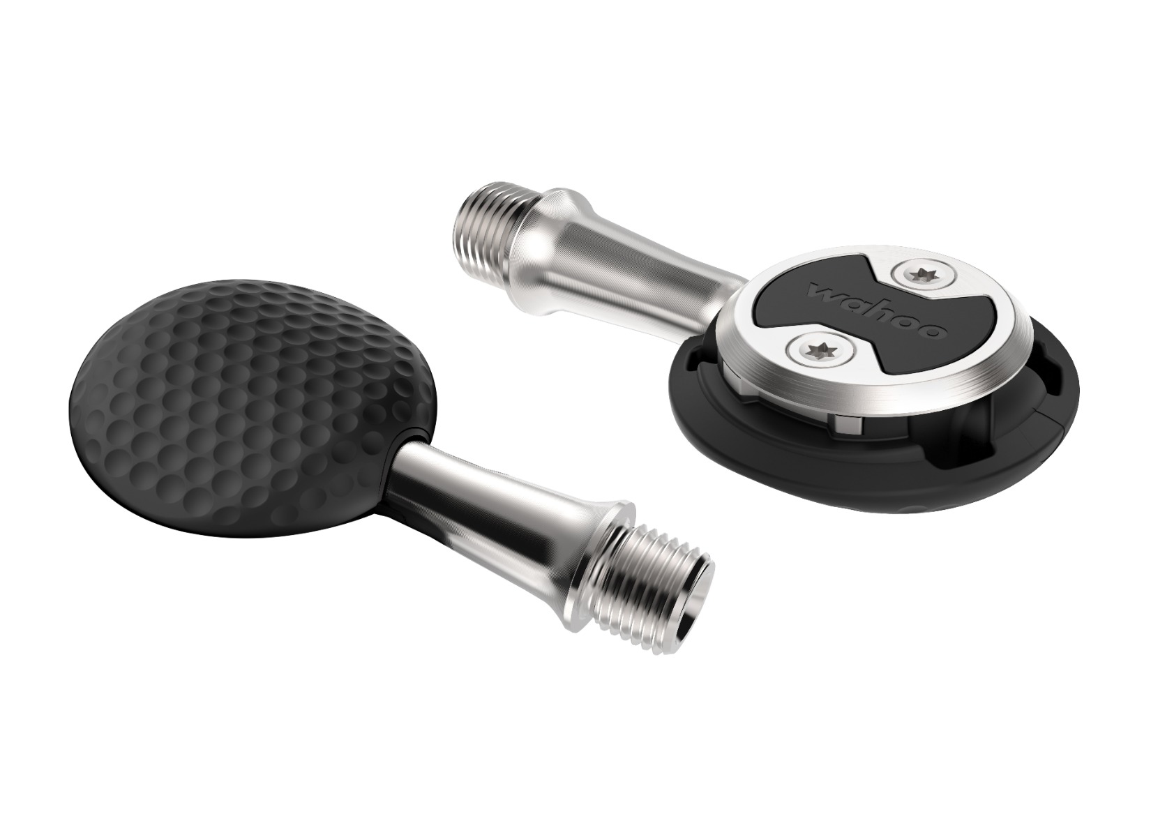

SPEEDPLAY AERO
Aero Optimized
SPEEDPLAY AERO
Aero First. Everything Else Second.
CA$389.99
The only SPEEDPLAY pedal with an aerodynamic dimpled underside — sacrificing dual-sided entry for measurable drag reduction in time trials and triathlons.
Purpose-built for TT and triathlon. Wahoo CFD testing claims a 22-second advantage over 40km at 40km/h versus a standard road pedal. Dan Bigham used the AERO when breaking the British hour record.
224g Per Pair
22s Over 40km
Single Sided
11.5mm Stack
37° Clearance
What makes the AERO different
The underside features a streamlined, dimpled surface that integrates with the cleat surround to form a low-drag profile — meaning this pedal only clips in from one side. In a TT or triathlon you clip in once and stay clipped in; the aero benefit over 40km outweighs seconds lost to single-sided entry. Uses the same stainless steel spindle and Grivory body as the ZERO, adding just 2g. Identical cleat interface — your cleat position and shoe setup transfer directly from any other SPEEDPLAY.
Dimpled aero underside: single-sided by design
A streamlined, dimpled underside integrates with the cleat surround to form a low-drag profile. Clip in once, stay clipped, and the aero benefit compounds over TT or triathlon distance.
Single-sided entry: know the trade-off
Every other SPEEDPLAY is dual-sided. The AERO is not. Optimized for sustained speed, not versatility. Use it for events where aero matters; a ZERO or COMP for everything else.
Stainless steel spindle at 224g per pair
Same stainless steel spindle and Grivory body as the ZERO, plus the aero plate. Adds just 2g per pair over the ZERO. No rider weight restriction.
11.5mm stack compounds the aero advantage
Low stack reduces frontal area by placing the foot closer to the pedal axis. Combined with the dimpled underside, the AERO offers two layers of drag reduction in a single pedal.
37° cornering clearance
The aero plate slightly reduces cornering clearance to 37° vs 39° on all other models. Rarely relevant for TT and triathlon courses — worth noting for road racing with tight corners.
Same cleat, same shoes, same fit
Identical SPEEDPLAY cleat system as every other model. Race TTs on the AERO, train on the ZERO — cleat position, float settings, and shoe setup transfer directly. No refitting required.
AERO technical specifications

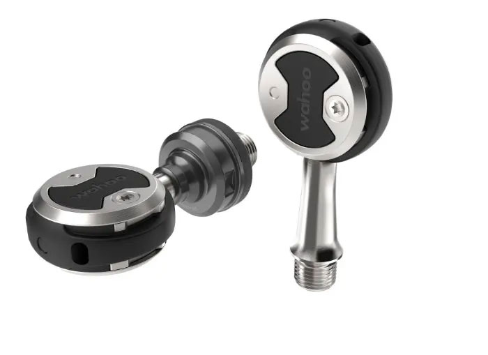

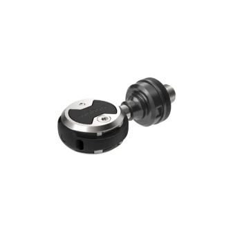

SPEEDPLAY POWER Single-Sided
Power on a Budget
Power Data Without Rebuilding Your Setup.
CA$879.99
The most affordable way to add power measurement to the SPEEDPLAY platform — left-side sensing estimates total power without requiring dual-sided investment.
Left pedal contains the power sensor, gyroscope, and rechargeable battery. Power is measured on the left and doubled to estimate total output. ANT+ and Bluetooth broadcasting. 75-hour battery life via magnetic USB-C adapter.
±1% Accuracy
75hr Battery
~250g Per Pair
Left Side
IPX7 Waterproof
What makes the POWER Single-Sided different
The left pedal measures left-leg power and doubles it to report estimated total power — accurate enough for pacing, zone training, and performance tracking. For riders with significant L/R imbalance, step up to the Dual-Sided. Dual-sided clip-in is preserved on both pedals since electronics live in the spindle. Stack height rises to 13mm and Q-factor widens to 55mm — check saddle height when switching from standard SPEEDPLAY.
Left-side power, doubled for total estimate
Measures left leg power and doubles it. Accurate enough for pacing and zone training. Riders with significant L/R imbalance will see less precise totals — if balance data matters, choose the Dual-Sided.
±1% accuracy, lab tested
Active temperature compensation adjusts for environmental changes during your ride. Auto-zero calibration runs continuously, keeping readings consistent from first pedal stroke to last.
75-hour rechargeable battery
Charges via magnetic snap-on USB-C adapter. No coin cells, no battery doors. At 75 hours, you can ride 5 hours a day for 15 days before needing a charge.
Dual-sided entry preserved
Electronics are integrated into the spindle, not the pedal body. Both the power (left) and standard (right) pedals retain dual-sided clip-in — identical engagement to a standard SPEEDPLAY Zero.
13mm stack, 55mm Q-factor: know the differences
Power electronics add 1.5mm stack (13mm vs 11.5mm) and widen Q-factor by 2mm (55mm vs 53mm). Left-right cleat adjustment reduced to 6mm. Check saddle height when switching from standard SPEEDPLAY.
ANT+ and Bluetooth dual broadcasting
Broadcasts simultaneously to unlimited ANT+ devices and up to three Bluetooth connections. Pair with an ELEMNT head unit, Zwift on your phone, and a training app all at once.
POWER Single-Sided technical specifications

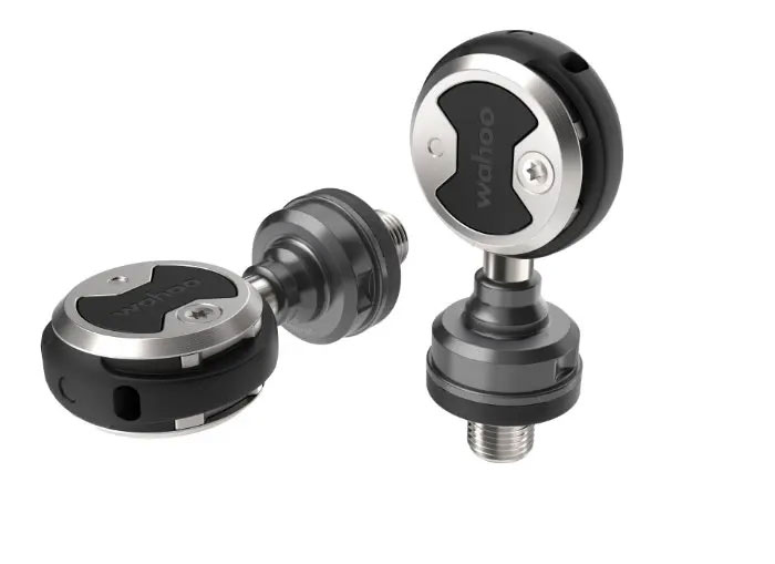

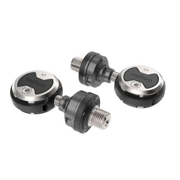

SPEEDPLAY POWER Dual-Sided
True L/R Power
True Left/Right Power. No Estimation.
CA$1,199.99
The only SPEEDPLAY pedal with true dual-sided, independent power measurement and left/right balance data — eliminating the need for a crank-based or hub-based power meter.
Both pedals contain independent power sensors delivering true L/R power without doubling or estimation. Lab-tested ±1% accuracy, active temperature compensation, 75-hour battery life per pedal, full Wahoo ecosystem integration.
±1% Accuracy
75hr Battery
276g Per Pair
L/R Balance
IPX7 Waterproof
What makes the POWER Dual-Sided different
Each pedal contains its own strain gauge and reports power independently. Total, left, right, and L/R balance are all measured directly — not estimated. Active temperature compensation, continuous auto-zero, and independent lab-confirmed ±1% accuracy. Each pedal charges via magnetic USB-C and holds 75 hours. ANT+ to unlimited devices plus Bluetooth to three concurrent connections simultaneously.
True left/right independent power measurement
Each pedal has its own strain gauge. Total, left, right, and L/R balance are all measured directly. Matters for riders rehabbing injury, correcting asymmetry, or structuring intervals by leg contribution.
±1% accuracy across both pedals
Both sensors individually calibrated to within 1%. Active temperature compensation plus continuous auto-zero — consistent power data from warm-up through finish line.
Left/right balance: data that changes training
A 55/45 imbalance during threshold tells you which leg fatigues first. Post-ride analysis on ELEMNT, TrainingPeaks, or Strava breaks this down by interval, lap, or entire ride.
75-hour battery on both pedals
Each pedal charges independently via magnetic snap-on USB-C (two adapters included). 75 hours per charge — every two to three weeks for most riders. No coin cells, no battery doors.
13mm stack height and 55mm Q-factor
Power electronics raise stack to 13mm and widen Q-factor to 55mm. Left-right cleat adjustment is 6mm. Applies to both Power models — adjust saddle height when switching from standard SPEEDPLAY.
Pair with ELEMNT BOLT, ROAM, or ACE for real-time power display. Broadcast to Zwift, TrainerRoad, or any ANT+/Bluetooth app simultaneously. Wahoo app handles firmware, calibration, and configuration.
POWER Dual-Sided technical specifications
