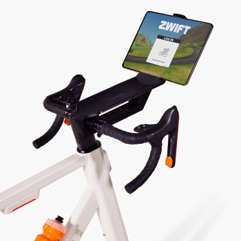

Upgrade to Zwift Ride V2 Smart Frame and transform your Zwift Ready or Zwift Compatible KICKR smart trainer into an always-ready, all-in-one smart bike. Built-in handlebar controls Zwift and enables customizable virtual shifting. Zwift Ride V2 Smart Frame is easily adjustable, making it perfect for everyone at home. Keep your outdoor bike ready for the outdoors and upgrade to an all-in-one indoor cycling solution that’s always ready to go.

  • Handlebar controls queue workouts, fire PowerUps and send RideOns without pausing
  • Silent virtual shifting with a customizable gear setup

  • Effortless Control
    Control Zwift easily from your handlebars. Queue workouts, use PowerUps, and send RideOns—all without pausing your ride.
