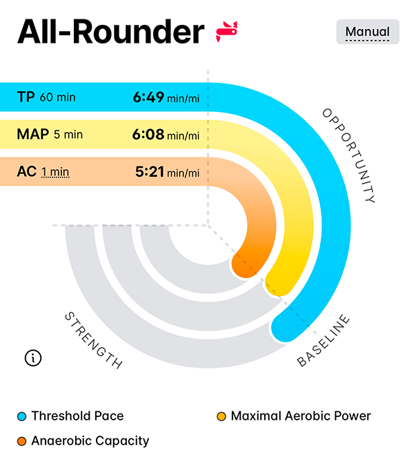

What Exactly is the 3DP Athlete Profile?
3DP stands for Three-Dimensional Pace Profile. Instead of collapsing your running fitness into a single number, a finish time, a pace, a VO2max estimate, Wahoo maps it across three distinct physiological dimensions.
The three dimensions are:
Threshold Pace (TP): The pace you can sustain for roughly one hour before fatigue catches up with you. It’s the cornerstone of all endurance running and the number that governs your long runs, your recovery days, and your race pacing from 10K through the marathon. This is what most runners often refer to as “tempo pace.” But TP alone, as we’ll see, is only part of the story.
Maximum Aerobic Pace (MAP): The fastest pace your aerobic engine can sustain for approximately five minutes. The kind of all-out effort you’d produce in a 1500m or mile race. This is your aerobic ceiling, and here’s what almost no runner understands: your TP can only ever rise as high as your MAP allows.
It’s a limitation many runners experience without ever naming it. A runner who is highly aerobically developed may have a perfectly dialed marathon pace, but push even a few seconds per mile beyond it and they redline immediately, unable to recover. That sweet spot where you’re locked in but can’t push further without falling apart? That’s a MAP problem,  and you’d never know it from looking at your finish time.
Anaerobic Capacity (AC): The maximum pace you can hit during a one-minute maximal effort performed under accumulated fatigue. Your kick. Your surge response. Your ability to answer an attack in the final mile of a race when your legs are already screaming. This is the dimension that separates runners who race from those who simply run. And crucially, your MAP ceiling is itself constrained by your AC, meaning that neglecting shorter, harder efforts in favor of purely endurance work can quietly cap how fast you’ll ever get at any distance.

Your Running Athlete Profile: Knowing What Kind of Runner You Are
Once 3DP has measured your three dimensions, something genuinely useful happens: it tells you what kind of runner you are.
Every profile generates a Runner Type: a description of the shape of your fitness, not the level of it. These aren’t rankings. An elite Marathoner and a recreational Marathoner share the same dimensional shape: high TP, lower MAP and AC. One is just faster. The types are:
  • Speedster: High AC, moderate MAP, lower TP. Built for fast finishes and repeated surges.
  • Miler: High MAP, moderate AC, lower TP. The aerobic powerhouse who dominates shorter distances.
  • Climber: High MAP and AC relative to pace. Thrives on variable terrain.
  • Tempo Ace: High TP, moderate MAP, lower AC. The grinding endurance engine built for 10Ks and half marathons.
  • All-Rounder: Balanced across all three. No obvious weaknesses, no dominant weapon.
  • Marathoner: High TP with lower MAP and AC. Built to go long and go long efficiently.
Knowing your type reframes how you think about your running. Instead of feeling slow or weak, you understand your identity. And more importantly, you understand which dimension is the lever you need to pull to actually improve.
