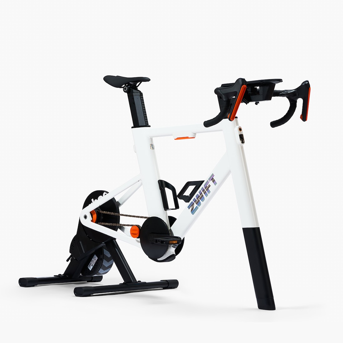

Zwift Ride V2 with KICKR CORE 2 offers an all-in-one, complete setup to unlock the best virtual experience in the worlds of Zwift and ROUVY. The proven KICKR CORE 2 smart trainer sets the foundation for responsive resistance and reliable power, paired with the Zwift Ride Smart Frame to enable seamless control of your Zwift riding experience at your fingertips.
Designed with simplicity in mind—a single tool that stows away on the frame is all it takes to assemble, dial in your bike fit, and adjust between users. Zwift Ride includes all of the hardware you need to get started on Zwift.
Zwift Ride has been updated to include multiple crank lengths, more saddle adjustability, and redesigned, larger-diameter handlebars, making it easier than ever to get set up, get comfortable, and start riding.

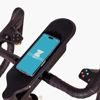

Control all of Zwift without ever taking your hands off the bars. Navigate with ease to queue your next ride or workout, shift through gears, use PowerUps, give a Ride On, and more.

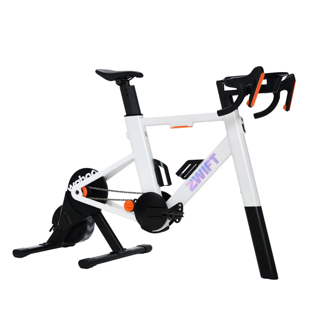

Smart trainer with Zwift Cog
WAHOO KICKR CORE 2
Frame with integrated controllers
ZWIFT Ride V2 Smart Frame
  • Handlebar with Controllers
  • Thru Axle
  • Allen Key
  • Phone Tray Mat
  • Frame Key
  • Left & Right Pedals
  • Charging Cable for controllers
  • Cable Tidies

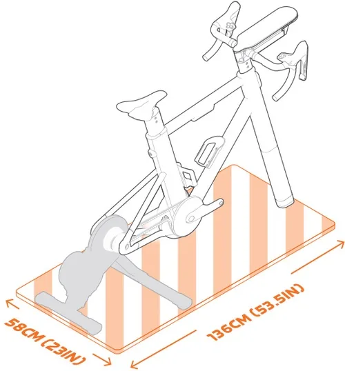

Product Dimensions and Frame Specs
  • Product Dimensions: 135.9 cm L × 60.2 cm W
  • Product Weight: 35.4 kg

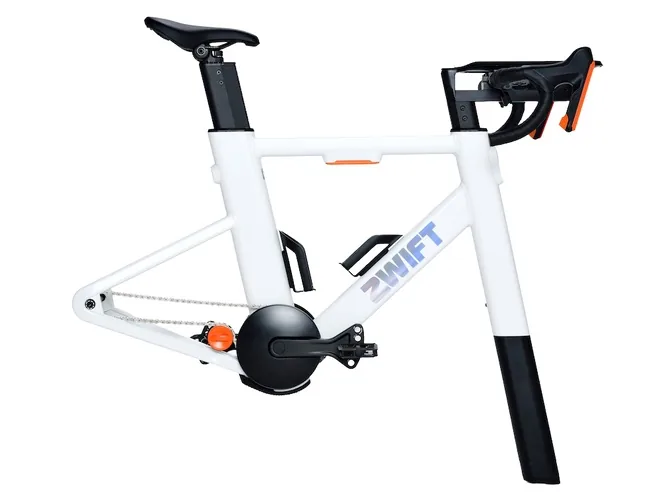

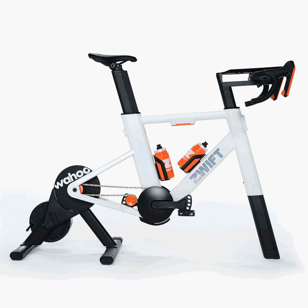

The Zwift Ride V2 bundle now comes with the upgraded Wahoo KICKR Core 2 trainer, replacing the original Core. While the smart frame itself remains unchanged—still offering built-in controllers, virtual shifting, and full rider adjustability—the Core 2 adds major enhancements. Key upgrades include WiFi connectivity for seamless updates, Race Mode with faster data transmission, KICKR Bridge for sensor consolidation, improved stability with redesigned legs, clearer multi-color LEDs, and a refined flywheel for a more realistic ride feel. Since September 2025, all new Zwift Ride V2 bundles include Core 2, giving riders a more connected, responsive, and reliable indoor cycling experience.
